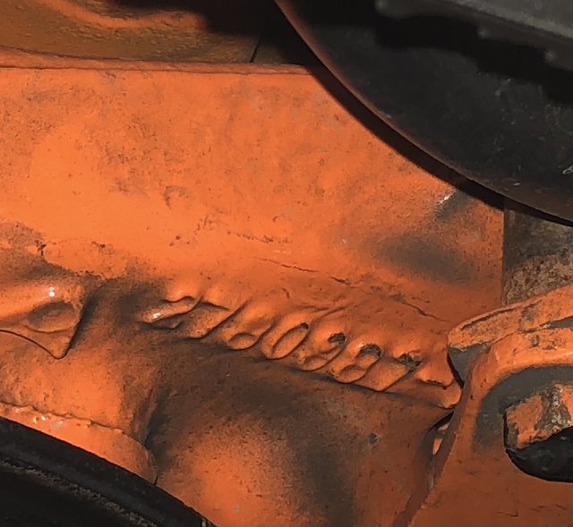

Hi all does anyone know what these numbers mean on my 70 Charger 383 ?
I assume the "70" in the 2nd pic means built in 1970 ?
Anyway to tell if it's the original engine ? As far as
I can tell none of those numbers match with the vin on my car
Many thanks for any help

JMF
Thanks for the reply, I checked the numbers and the vin is the same on the block so it's the original engine
I checked the transmission and can't find the vin on that though, I know it's supposed to be a pad on the passenger side but can't find that at all, could it be a warranty transmission maybe ?
Thanks

JMF
Thanks couldn't really find the vin anywhere though on the bellhousing as the exhausts are kind of in the way
Only this
Alaskan_TA
No raised flat pad on it?
If so, it could be 1968 model year or older.
Check the pan rail on the driver's side for part number and date code info too.

JMF
Hard to see but these are the numbers if I'm reading it correctly
22813 DP
C
66
John_Kunkel
STAMPED number, not raised casting numbers.
