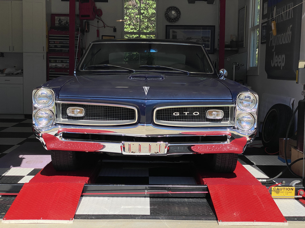

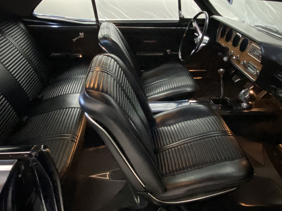

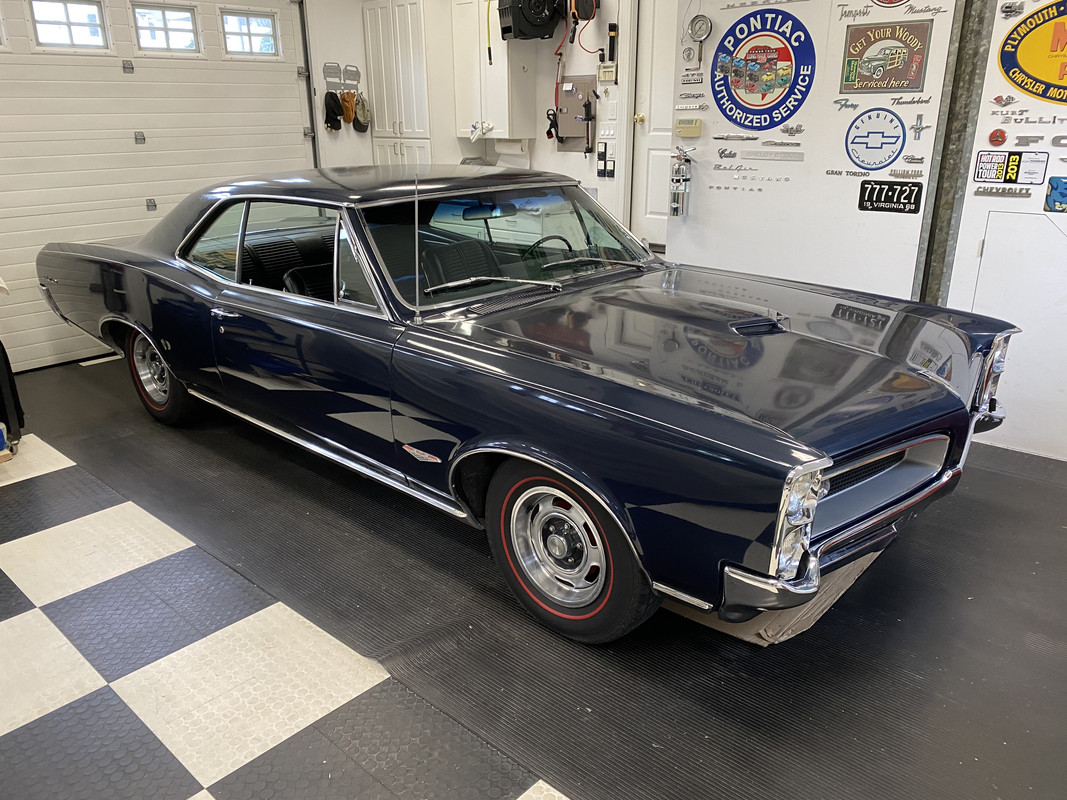

Picked up the next car a 1966 Pontiac GTO a few weeks ago in Minnesota. Original paint, chrome, interior, engine, trans, and rear! Unmolested 61,000 mile surviver. Car only had 16000 miles in 2002. Amazing documentation from all 3 owners.
No restoration for this car just paint correction cleaning and detailing preservation!
Drove it 1200 mile back home, used/ leaked 1/2 qt of oil. Ran great and made about 13+ mpg.

"Drove it 1200 miles home" - that is awesome. I want to be Pat in my next life.  :cheers:

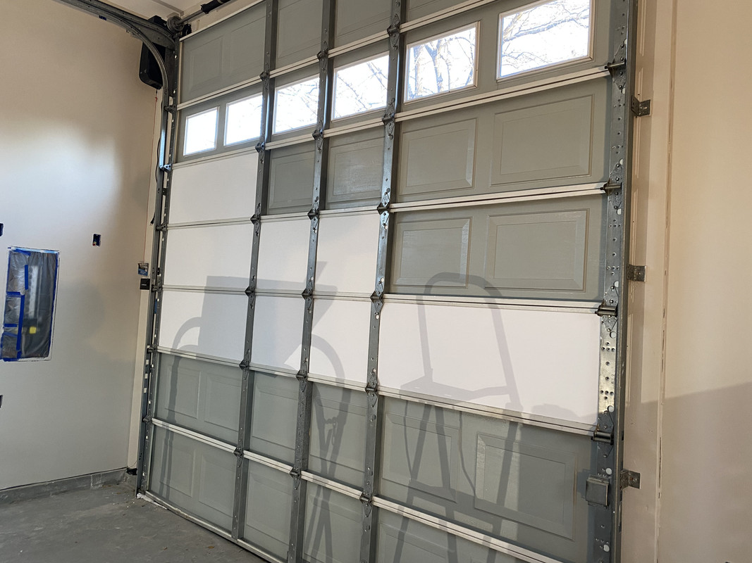

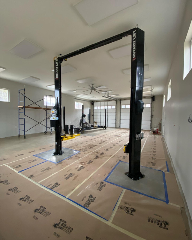

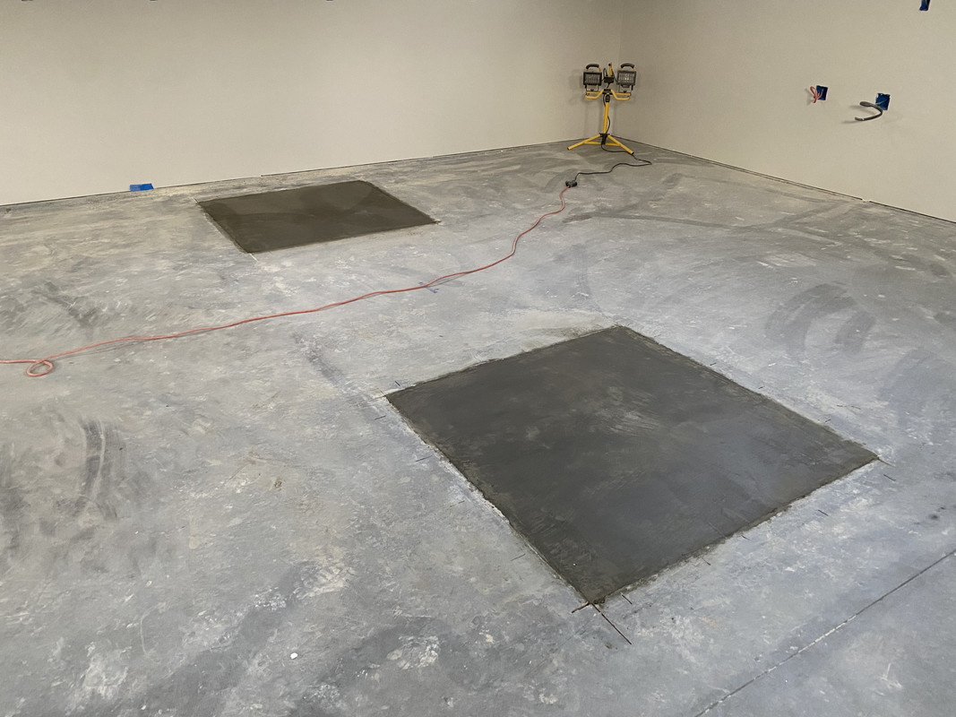

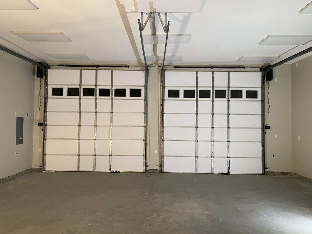

Making progress on the new shop. All the electrical work is complete just waiting for BG&E our local power company to hook up the meter. I was concerned that the slab was a little thin for the two post lift so I opted to cut two 4'x 4' holes and had two 5'x 5'x 14" slabs poured. Also insulated both of the 12' x 12' doors. Cabinets and lift will be here first of the year.

Pat that is a real find! I am a Mopar fan but love a Pontiac! I am working on a 69 GTO 400 4bbl Ram Air III 4 speed car now. It is a Mopar site I know but I would love to see a few more pictures like under the hood and interior. I was going to message you as I have a few questions on the engine in your Charger. I have a hemi I want to put in my 72 Charger. Anyway you really scored on the goat.

I've said this before but I think the Pontiac and the Mopar muscle cars of the 60s are very similar and I think it might be the one brand a hard-core Mopar or a hard-core Pontiac guy would own. I just spent the last month wet sanding compounding and polishing the 55 year old lacquer paint on the GTO. And the car looks amazing for its age. Below is a link where you can see a lot of great pictures when the car was new and how the car looks today. Feel free to message me with any questions you may have on your hemi swap.

Pat, just went through the thread of the GTO - WOW!   Great results!  Car looks fantastic!

Mike, Thank you! It's a cool time capsule and I'm very happy with how well the paint came back. It's a different kind of cool compared to the Charger.

Awesome job on the GTO, she is beautiful!
Seems some were nervous about your approach but seeing your abilities to turn the Charger into a mirror I had no doubts  :2thumbs:

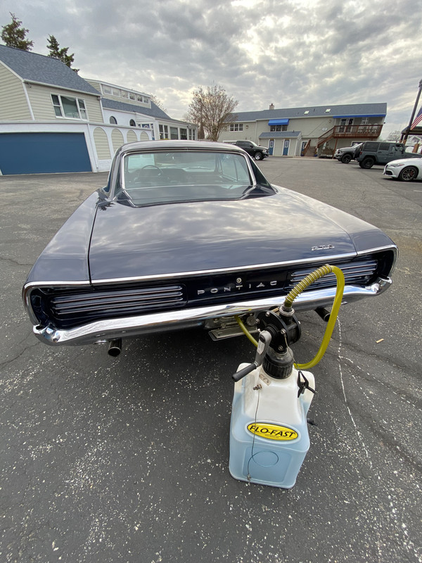

Thank You sir! I am very happy with how it turned out and it's an easy car to drive and not have to worry about every little chip or scratch. I had it out yesterday, it was thirsty;-)

That is a cool fuel can. Are you running special fuel in your cars?

Yes, they are great fuel cans we have 4 of them at the marina. 7 1/2 gallons each and we use them to fuel the tenders on the yachts and my cars when no one's looking;-) We use AV fuel which is 100 octane low lead. It has a great shelf life and it's about $6.00 gal. Here in Maryland we don't have easy access to non-ethylene fuel so I run AV fuel in all of my cars that don't have catalytic converter's (because of the low lead)

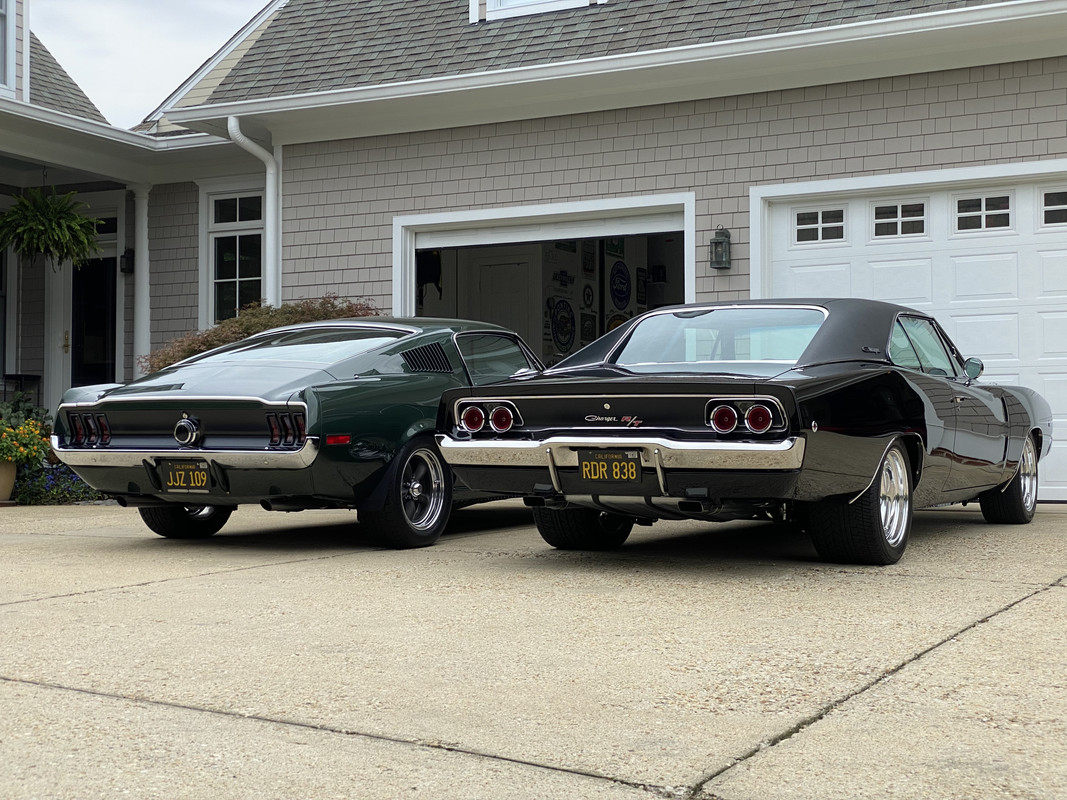

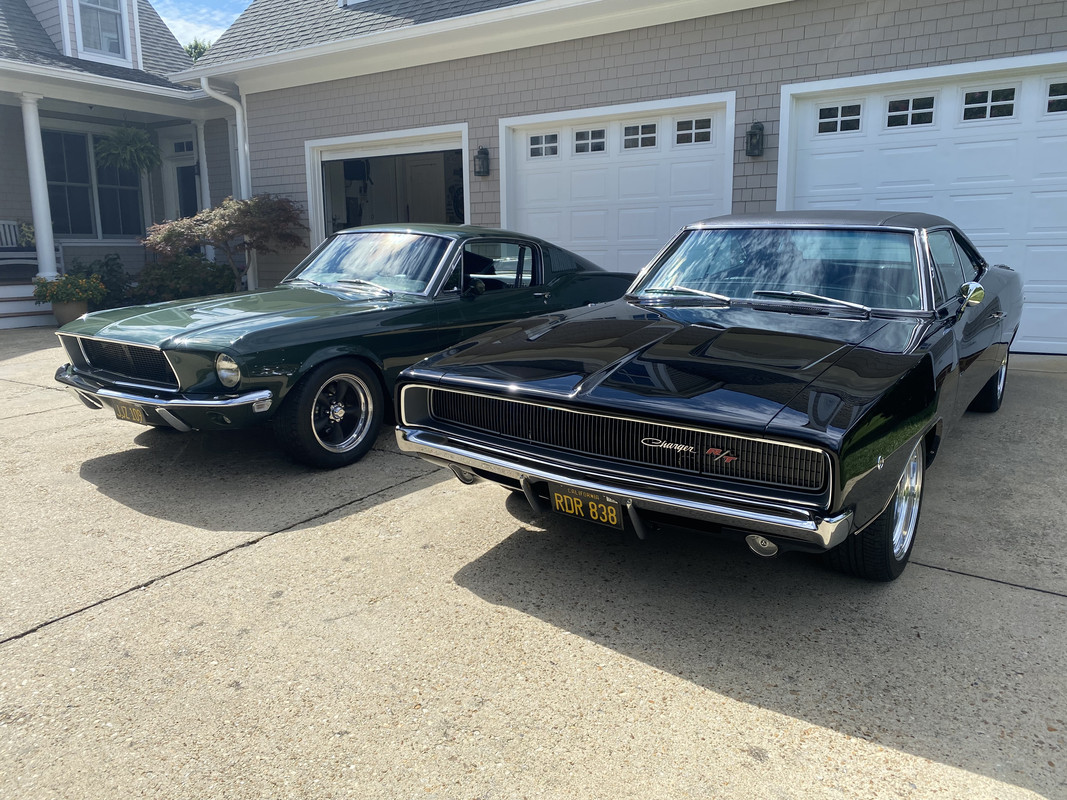

We are registered for the HotRod power tour this June. Kurt in his Bullitt Mustang and me in the Bullitt Charger. I'm excited to hit the open road with both car! It will be about 2800 miles round trip. It's been about 9 years since going on the tour with Kurt's Mustang.

Sounds like some great fun Pat. Just make sure your Bullets pull up to the gas pumps properly...  :icon_smile_big: .. and not McQueen style..

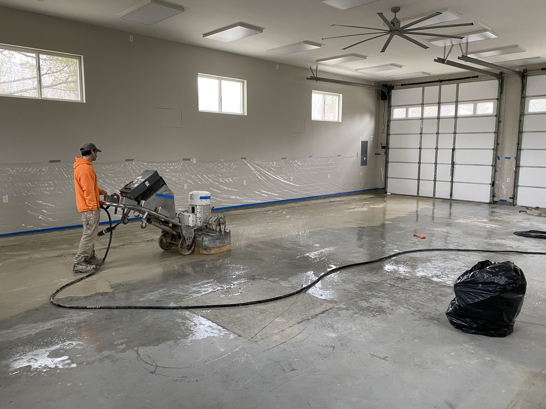

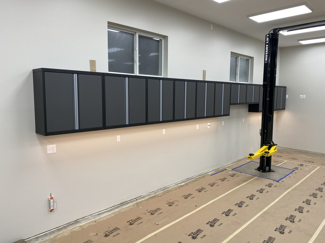

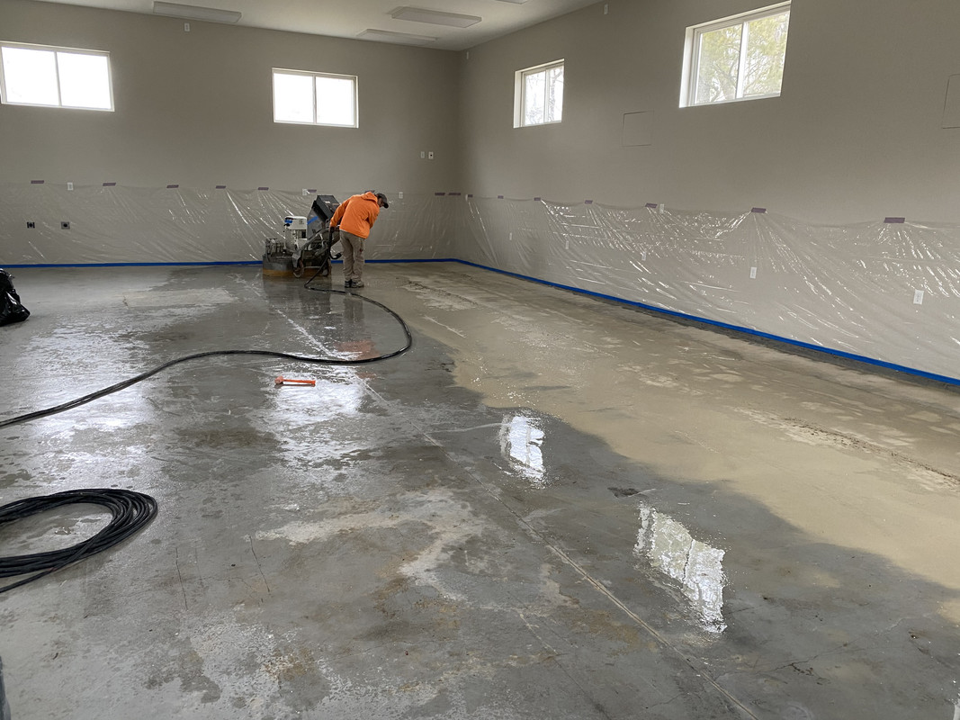

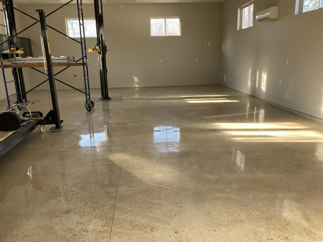

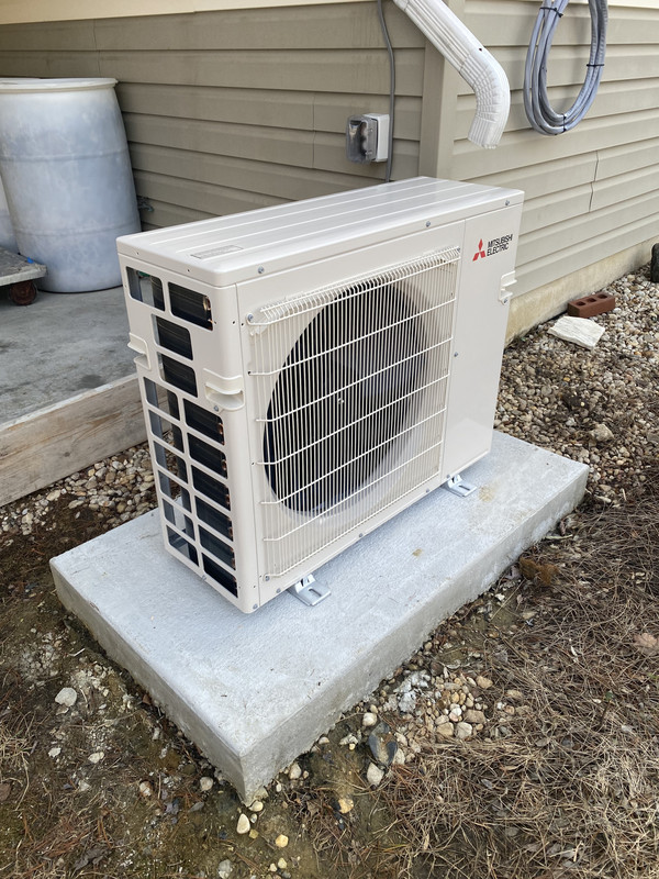

New shop update. The power is on, floors are polished and sealed, lift is installed, wall cabinets installed, and the heat/air system up and running! I will be installing the base cabinets this weekend. Should be ready for my car projects soon!
Thanks
Pat

That's awesome Pat. My garage is about as wide as your 2 post lift which means working on the car is quite a challenge.

Still better than working outside on the driveway like we used to do in our teens;-)

Beautiful shop Pat. How tall are the walls? I went with 12 foot and wish I had put 14 footers. I have 2 lifts and it is ok for cars but not for SUV's or pickups. I went with 2 , 4 post lifts so I can move them if I want to. I wish I would have gone with 1 , 4 post and one 2 post. The 4 posts don't allow to lift leaving the suspension hanging. Anyway great shop. I hope we will see many more cool builds.

The ceiling are a little over 13' high. The standard two post lift is 12' tall but I ordered this one with a 12" extension, lift is about 3" from the ceiling. When I bought the property (for the garage;-) it came with the 4 post lift and casters. Nice thing about the 4 post lift with the casters is that you can roll it outside to power wash or clean $ degrease the bottom of a old car.
