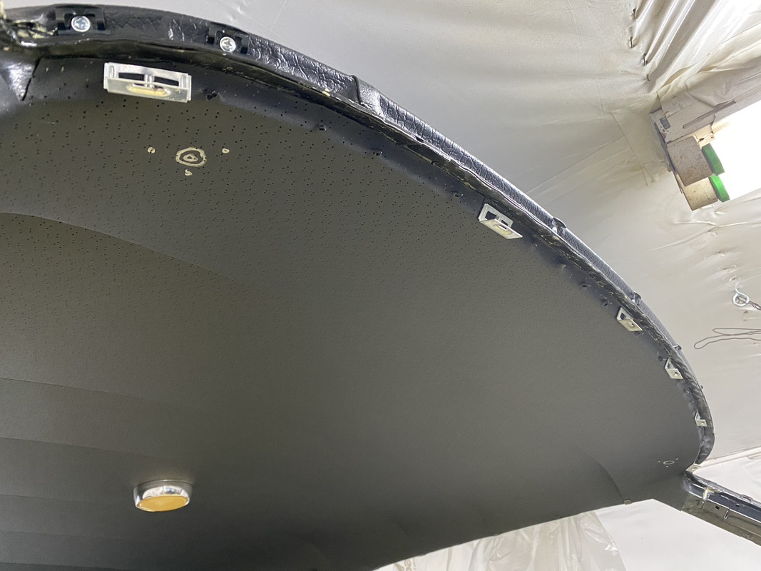

good GOD man that thing is gorgeous!!!!   maybe you can help me? I am almost done with my 69 charger and am down to the annoying small items that seem to take longer than the entire restoration.  for the interior upper windshield trim there are these clips (picture hopefully attached) but I can't figure out how they go back in for the trim to screw to??? appreciate if anyone has a photo or something that shows how they sit and what they may clip into?
keepat
You should find six square holes in between some of the spikes that hold the headliner in position. Then you use a pair of small pliers after you shove it into the square hole pinching the center clips together holding it in position.

Pat you are a life saver. I would never have guessed that positioning!  I'll try and post some photos of where I'm at with my project. I went through this entire series of your restoration and am completely in awe of your skills and attention to detail. Makes me wish I had taken even more time in my 16 year project. I went vintage air also.  Thank you again!

Quote from: crashirv on December 06, 2019, 03:42:51 PM
Pat is right about the position, but the metal on the repro ones I got were so hard and brittle that the little tabs, he talks about squeezing on, just broke off instead of gripping.  Where did you get yours Pat?  I ended up drilling a little hole thru the clip and the sheet metal and putting a tiny sheet metal screw in.  Never going to come out but you couldn't remove it without pulling the windshield.
Mitch, I was able to reuse my original clips. Doesn't surprise me that the repro's don't work as good as the originals
