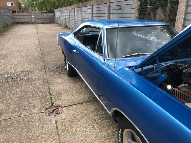

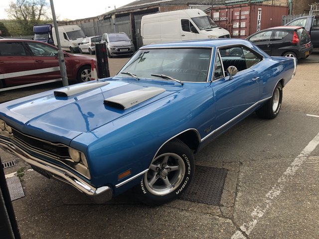

So I'm buying some new AR Outlaw 1 wheels this week hopefully for my 69 Coronet but I'm undecided on the size for the rears
Currently on the car I have
15 x 8
3.75" backspace
295/50/15's
Please see below pics
Either side there is about 2" clearance between the edge of the tire and wheel arch lip , although the drivers side is a little bit tighter , maybe just 1.5" , plus there is that b body bulge on the inner wheel arch
So the options I have are
15 x 10
4" backspace
Use Current 295 tires
15 x 10
4" backspace
275/60/15 tires
15 x 8
3.75" backspace
15 x 8
3.75" backspace
275/60/15's
Ideally I want to buy the 15 x 10's but do you think they will will rub with either of those tires on that backspace , I do seem to have quite a bit of room as the car is a little jacked up on the rear I think
Also anyone ever tried the 255/70/15 size ?
70 profile not 60
Many thanks
