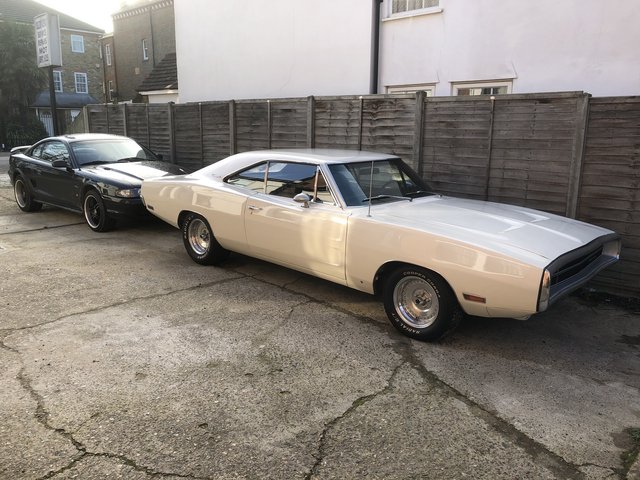

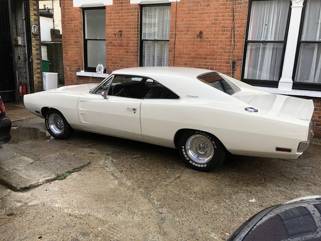

JMF
Thanks for the replies , I currently have 275/60/15's on the rear , I think it looks ok but it sits a bit low at the back in my opinion , I was thinking a taller tyre would raise it a little
Nacho-RT74
you don't have a tire issue but springs issue

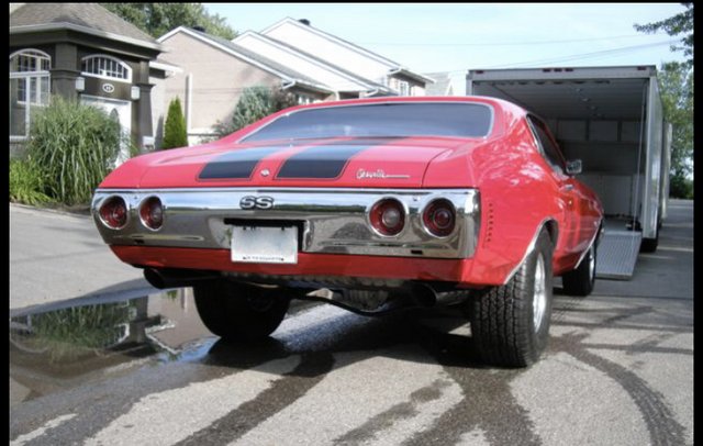

chargered
I have 305s on the back of my 70.  I would post pictures, but can't figure out how to do it on this damn forum.

Nacho-RT74
Quote from: chargered on January 08, 2021, 11:21:02 PM
But I guess 305/50 or something like that? 305 is the width in mm. Next number is the % of the width as the sidewall height. A 305/50 will be 305 mm width and 152.5 mm as sidewall height. 305/60 will be higher of course being 183 mm sidewall height.
But 285/70 is even higher, being 199,5.
This number needs to be multiplied x2 plus the rim diameter to get the total height/diameter.

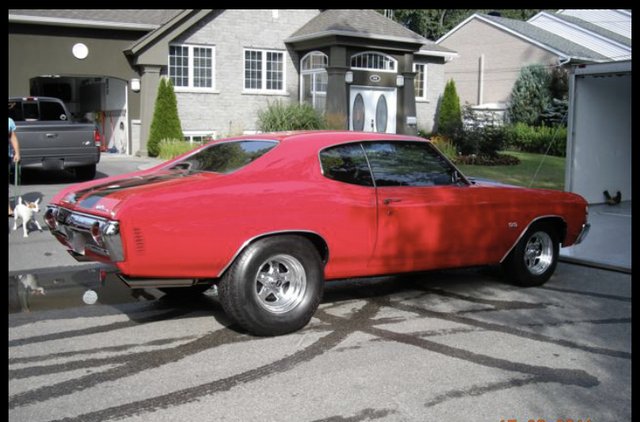

chargered
In the back I have 305/45/17 and in the front 235/55/17.  I like the rear, it gives me a 28" tall tire with 12" width and I still have some decent amount of sidewall.

Kern Dog
Uhh....
XH29N0G
Strange.   :o
:o
:o
Is there a white dog in the passenger seat?

Nacho-RT74
And by the way it looks the actual tire into the wheel wells with the actual stance I'm pretty sure 285/70s will rub inside the wells &/or quarter wheel opening edge while driving.
nothing to do, new springs is the key, and will get higher stance on the actual tires size which is pretty much the correct diameter. Then will need to raise the front end to equalize and align.
Is just what I can see from the distance and the pic angle
