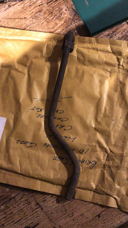

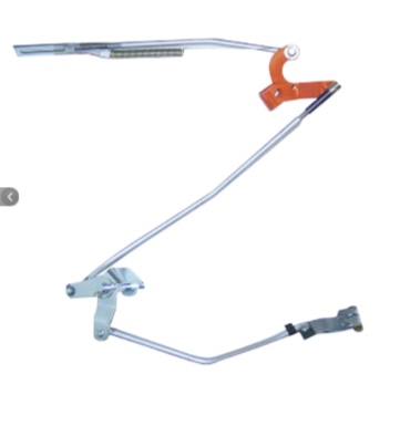

Thanks for the replies , I am just missing 1 rod for the old linkage system so will go with that rather than Lokar , someone near me has this rod for sale(pics below) which he's tested on a 727 and the ends fit ok but I'm a bit confused as to why the shape/bends of it are different compared to the one "Year One" is selling ? Any ideas ? Link below , my car is a 70 Charger with a 383, thanks

"Kickdown" is a general motors term. I believe chrysler calls it throttle pressure linkage. 2 completely different functions in 2 different style transmissions

What John K and Joe said.  You MUST use throttle pressure linkage on a stock valve body.  There is a good detailed explanation in Tom Hand's book on Torqeflites.
