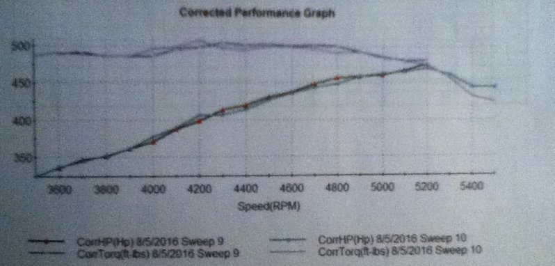

Windsor
Got the motor. I'm trying to get me scanner to work so I can show all the #s without typing them.
Compression is 9.5.
Sweep 9. Horsepower- 477 @5200rpm. Torque- 506 @4300rpm.
Sweep 10. Horsepower- 471 @5200rpm. Torque- 509 @4200rpm.
When I get my scanner working and get rid of my headache, I'll post more.

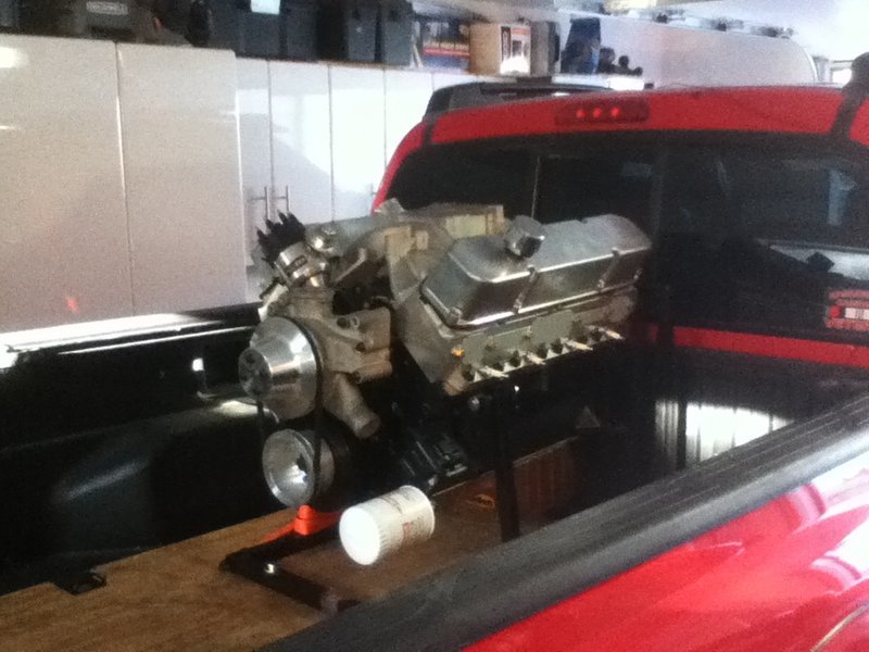

Windsor
Not a problem. 6 hours (plus 1 hour of sitting after a semi and f150 played bumper trucks at highway speed) of driving gave me a killer headache.
firefighter3931
Quote from: Windsor on August 25, 2016, 08:36:33 PM
Compression is 9.5.
Nice power numbers for a mild street build  :2thumbs:
I bet that torque curve is pretty flat......should be a great build for your application !  :icon_smile_big:
Looking forward to the build details and dyno sheets. Once that is posted up we can archive this one in the Proven Engine Builds forum  :cheers:

https://www.tacomaworld.com/attachments/image-jpg.1152837/
Once installed in the frame, I'll be modifying the oil pan for more capacity. If someone could repost the picture for me. It still won't let me load from my iPod.
