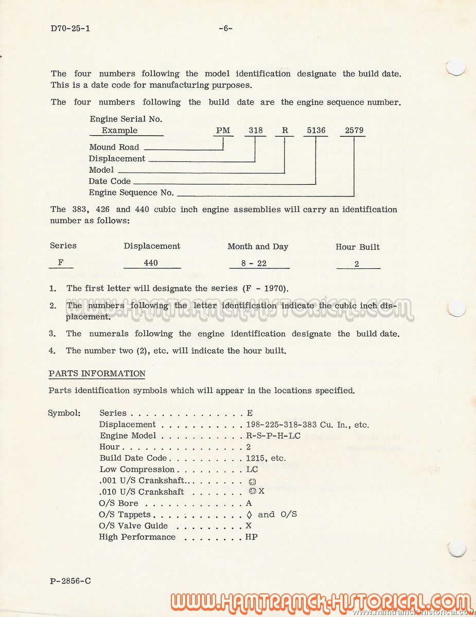

I know this has been discussed before, but I have been reading some conflicting posts regarding engine stampings. I have a 70 Charger R/T 440 and found the markings on the front lip:
F440
B (sideways)
8 1 1(may be a lower case L, hard to tell) HP
I think the F440 is 1970 440, but am not sure on the others.

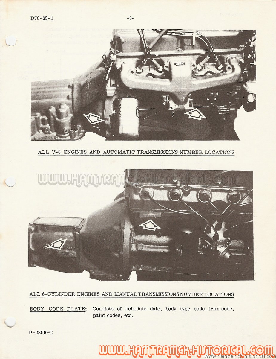

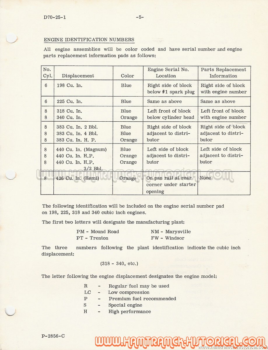

In addition, where can I locate the engine VIN stamp? Can someone provide a picture with an arrow please?

Thanks man,
I should be able to check that out tonight. I appreciate it.
Steve
imabozo
Found it no problem.
Thanks again.
