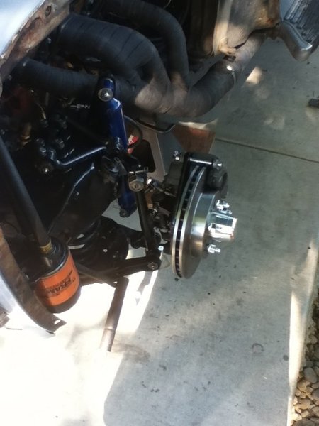

New wheels and wheel spacers came in today. Had to clearance the front calipers a bit to fit.

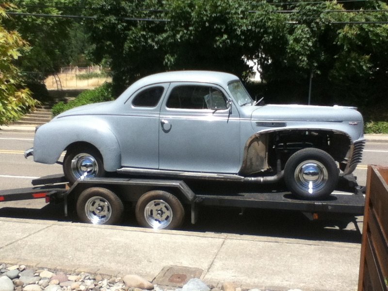

Got her put back together. Granted it took me almost 3 hours to put the fenders back on, definately a day I wish I had some Percocet. Alignment went well, got everything where it should be and she drives good too. Anyways, here she is with mirrors in the middle of the tires.
